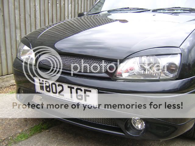

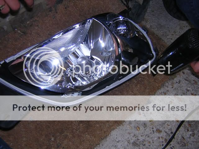

wprawdzie po angielsku... ale instrukcja "idiotoodporna"
You will need:
A hairdryer
Star headed screw driver
Flat headed screw driver
Silvertec bulbs - bought at mini trailers (cheepest place so far.. under a tenner for the pair)
and a can or coke or two for refreshments lol!
Before:
Step 1:

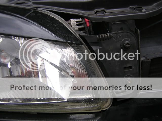

Open the bonnet and remove the grill from in-between the headlights, these unclip from 4 clips.. 1 in each corner. it should just pop straight out.
Step 2:

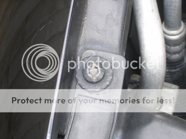

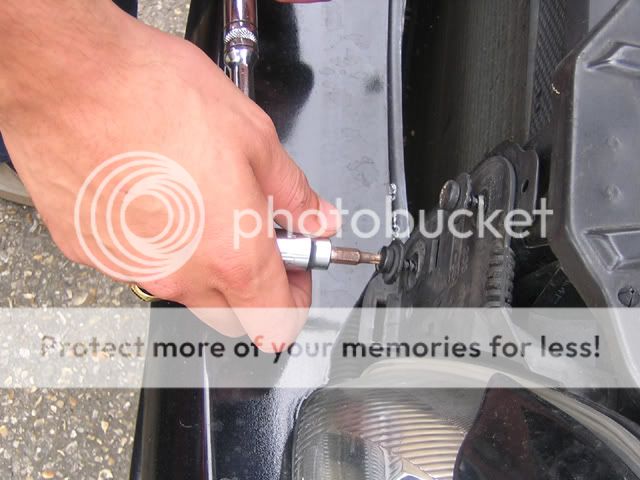

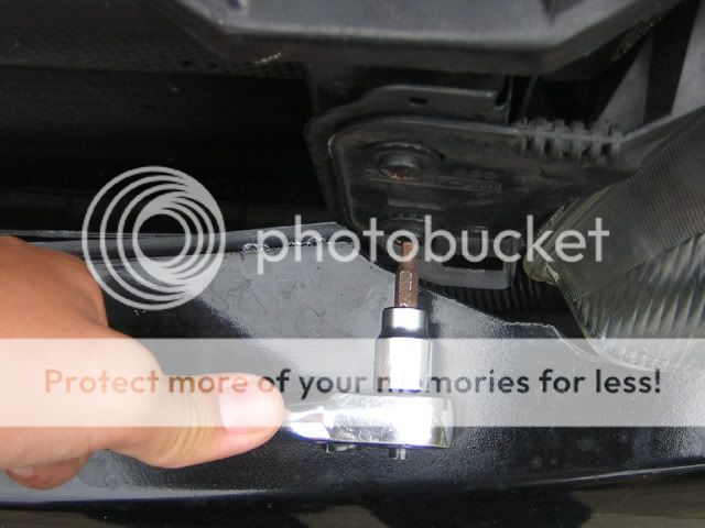

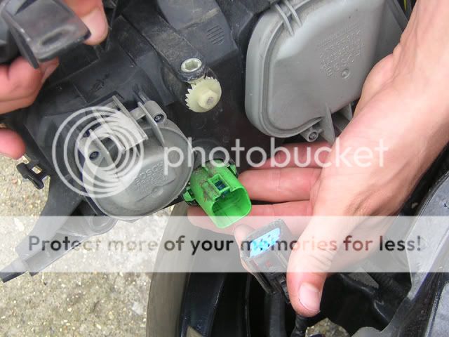

Undo 3 star bolts on each light. These are how the light is kept in place. 1 is above the light (pictured below)
The other 2 are on the inside edge (picture below)
Once these are removed pull the light away from the chassis and there will be a clip to remove the electrics from the headlight. Simply suppress the black clip and it should just pop off

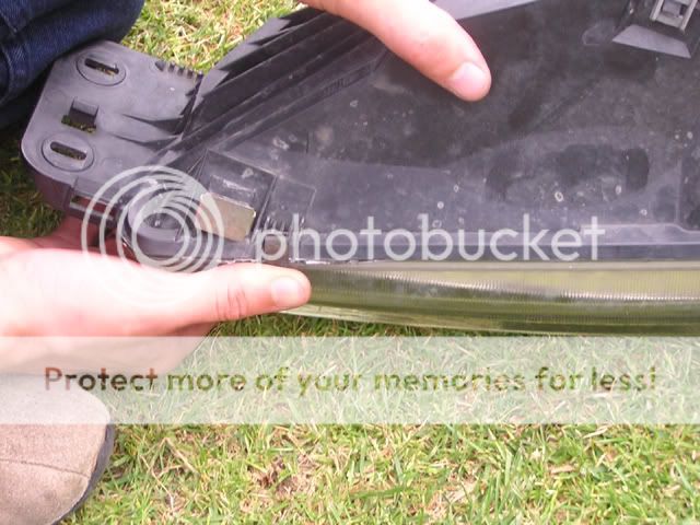

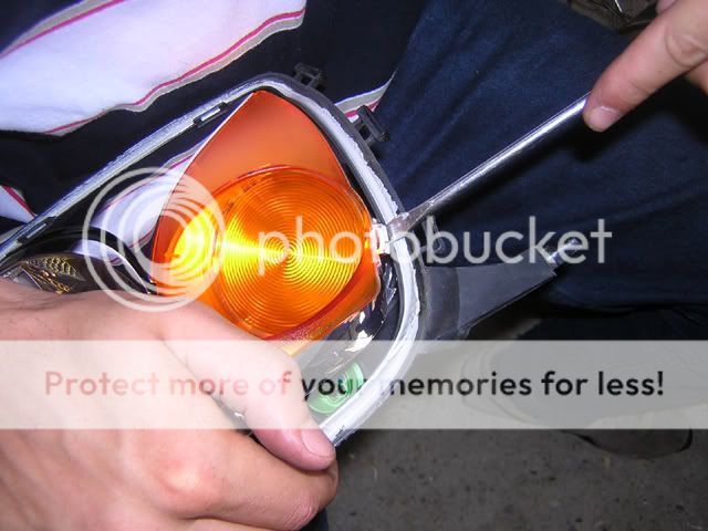

Step 3: Removing the lens
First you will need to remove the clips which hold the lens in place.. this is fairly easy just make sure they don’t ping off somewhere.. you should be able to do this with a flat headed screw driver.

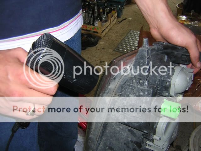

Once the clips are removed you will need to locate the female of the house's hairdryer. You will need this the heat the glue which holds the lens in place. Slowly run the hairdryer (on hot!! LOL) over the glue until it becomes tacky enough to prise away.
BE VERY CAREFUL WHEN PRISING GLASS! it has been to known to break before.
We used a flat head screw driver gently wedged behind the lens to remove the glass
It should begin to get easier once the first side is done and should just come away with a little pull

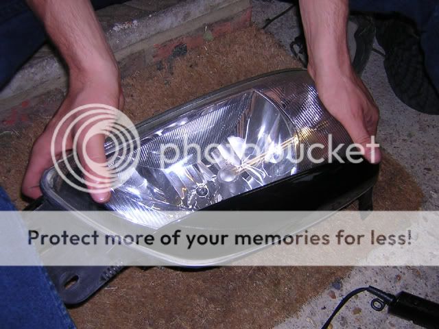

Step 5: putting it all back together again
This is the easy bit..... heat the glue back up again with the hairdryer and until it goes all tacky again.
pick up the glass and press in back down onto light
all that’s left to do is put the clips back onto the light and return the light to the car.
do make sure when putting the light back in you plug the electrics back into the light.. it goes in the same way it came out funnily enough.
Now you should be able to stand back and admire your work.. such a simple mod makes the car look so much better..
